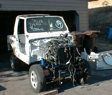

We Join Ted at the point where he had placed the body on the frame and reconnected the steering. At this point, he is attempting to hook everything together and make a running machine to make it to the CALMINI customer appreciation run.
Never, ever attempt building a rig with the idea of using it on a set date. I had Steve Kramer at CALMINI starting betting pools that I would not be able to make the Rubicon with this new set up. I bought two days! Some how, his egging me forced me back into the garage night after night despite work and family. I was going to do it. I kept a copy of the book, “The little Train that could” on my tool box next to “Dharma Bums” as a reminder of how and why I was building this car.
I finally got to the point of turning the key to start my “creation”. It cranked, and cranked and cranked some more. It didn’t fire. I sniffed the tail pipe and there was no fuel. I looked at the rat’s nest of wires that ran the Fuel Injection and wondered which one I had crossed or lost. Then my ever-observant son notice a wire near the license plate. I hooked it another loose wire near the tank and heard the fuel pump run. It was that dumb. It fired right away and sounded perfect!
